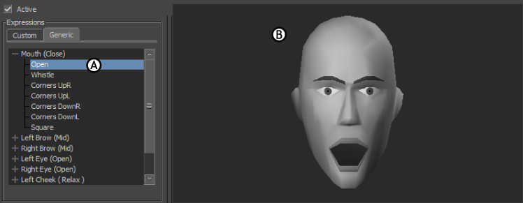

To preview the effect of a generic expression in the Character Face settings, select the expression in the Source list.
For example, the following figure shows the expression “Open” selected in the Character Face settings, and the corresponding facial expression displays on the model.
A. Generic expression for Mouth-Open B. Expression displayed on the Preview model
