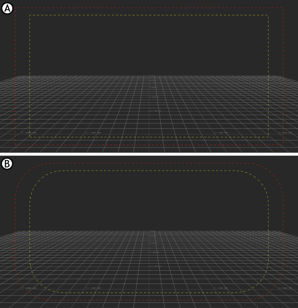

Safe Area
The Safe Area is a set of guides that mark the area in which titles or animation/motion should be placed. Anything that falls outside of these guides may be cropped when transferring to video.
Select Square or Round Safe Area from the Safe Area menu, then activate the Safe Area option to show or hide the Safe area in the Viewer window.
A. Square Safe area B. Rounded Safe area
Note:
If you do not observe Safe areas, titles and animation may be cropped when transferring to video.
