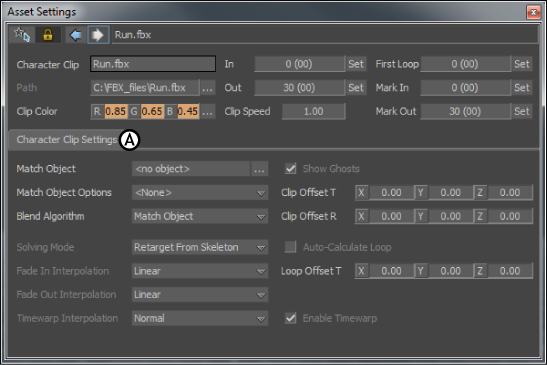

Additional clip settings (A)
Match Object field
Double-click an animation, character, or camera animation clip in the Story window to access the Match Object field in the Asset Settings window.
The Match Object field lets you select a match object for each selected animation, character, or camera animation clip. The match object you select affects how clips match. By default, a clip has no match object and the travelling node is used to match clips.

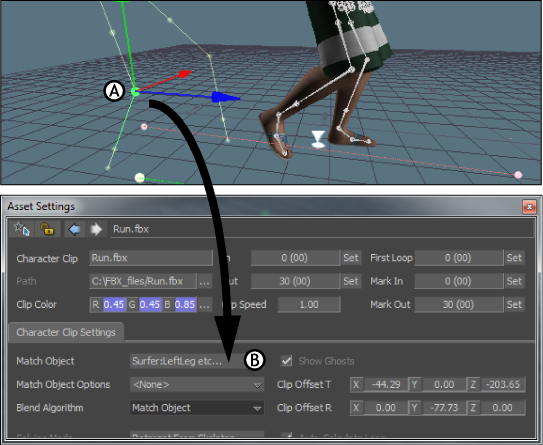

To select a match object, Alt-drag an object into the Match Object field. You should only select a match object from part of the track contents.
The content of the Match Object field is affected by the options selected in Match Object Options menu and in the Blend Algorithm menu. See Match Object Options field and Blend Algorithm menu for more information.
Selecting a match object A. Drag a selected node into the Match Object field B. The name of the custom match object displays in the Match Object field

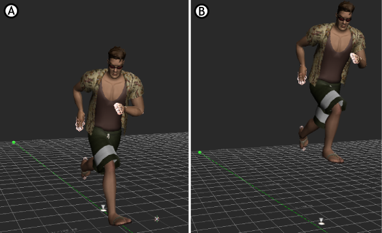

The Loop Offset T settings let you change the loop’s translation offset.
The loop offset is calculated automatically by default. Changing a loop’s translation offset causes the animation to jump at the beginning of each loop. For example, when you loop a basic run cycle, a Character runs forward in a straight line. If you change the loop’s translation offset, the Character jumps at the beginning of each loop.
Creating loop offsets A. The loop offset is calculated automatically, Surfer runs in a straight line. B. The loop is offset along the Y and X axes, causing Surfer to jump at the beginning of each loop
