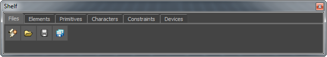

To access the Shelf tool, choose Open Reality > Tools > Shelf from the MotionBuilder main menu.
By default, the Shelf tool displays the New File, Open, Save, Save As options in the File tab. The following table lists other tabs and objects within each tab in the Shelf.
