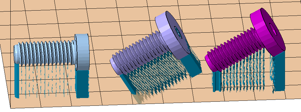

Three stages of rerunning support actions: Original, rotated and extruded part, reapplied supports.
