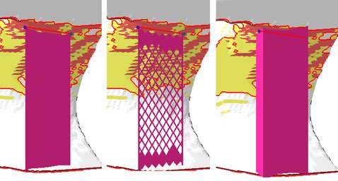

Polyline type
Sets the type of polyline.
From left: Open wall, Patterned open wall, and Solid wall
  • Open wall is similar to Patterned open wall without actual pattern selected, except it is simpler and has no dedicated, shaped connections.
  • Unless explicitly thickened, both Open wall and Patterned open wall are meshes without volume, intended to be exposed with a single beam pass where the thickness is formed by the melt puddle's diameter. If treated as regular meshes, as opposed to supports, this can be a source of complication during toolpath generation.
  • Solid wall counts as closed mesh with a valid volume.

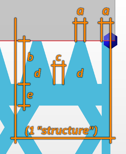

Connection
Connection
Top part Refers to supports terminating in part surface at its top end.
Bottom part Refers to supports terminating in part surface at its bottom end.
Platform Refers to supports terminating in the platform surface at its bottom end.
(Connection properties)
(Connection)
Type of connection
Select from: Strip, Trapoid, Breaking Points, Triangles.
  • Strip: A continuous band connecting to the part all along its upper edge
  • Trapoid: Triangles with truncated tips
  • Breaking points: Like trapoid, but with another, inverted row of trapoids stacked on top, forming X-shaped connections
  • Triangles: Triangles that simply terminate in corners, for very delicate support attachment
Connection width a
  • Does not apply to Strip.
  • For Triangles, this only applies to the vertical line at the beginning for the polyline, or contour.
  • For Breaking points, this is the "waist" of the X-shaped connections.
The width of the vertical strip on the far right can be overridden. See Structure properties > Border width.
Connection height b
  • For Strip, b and e are simply cumulative.
Pin distance c
Pins per structure d
Distance connection to structure e
Triangles on platform Adds reinforcing triangle-shaped ribs to the platform connection, perpendicular to the polyline or contour. Not available when Angled Block Support is active.
Distance
The interval between ribs
Width
The width at the base of the ribs. The ribs are always equilateral triangles, so changing the width modifies the height accordingly.
Platform connection This section defines the connection between support and platform ground.
Connection Type of connection. See above for reference.
Hatches Replicates the lower section of connections in parallel, up to 15 copies in each direction. This creates tapered, pedestal-like reinforcements. Accepts odd numbers up to 31 only, ignores even numbers.
Hatch distance Distance between replications
Triangles on platform Adds reinforcing triangle-shaped ribs or gussets to the platform connection, perpendicular to the polyline or contour. Not available when Angled Block Support is active.
Distance The interval between struts
Width The width at the base of the struts. The struts are always equilateral triangles, so changing the width modifies the height accordingly.
