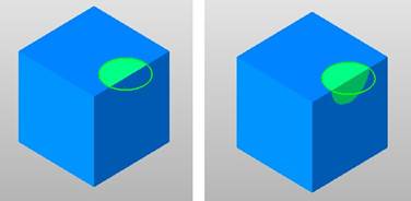

Paint on surfaces
  1. Select the part.
  2. Click Modify > Texture and color.
  3. From the toolbar, click Paint on surfaces.
  4. Paint the part with color as needed.
  5. Click Apply changes to apply the color to the part.
Painting on surfaces.
Left: A selection tolerance below 90°. Right: A selection tolerance above 90° and the brush now covers the adjacent side of the box.
