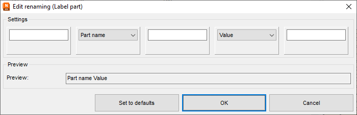

Step 1: Adjust renaming template for labeling
Modify how the name for labeled part clones is generated to meet the requirements of parametrized support generation on existing parts
  1. From the main menu choose Settings > Settings.
  2. Select Part renaming > Label part and click the button to open the associated Edit renaming dialog.
  3. Add a space character in the middle textbox.
  4. Clear the contents of the last textbox.
    The Preview should now read Part name Value.
  5. Click OK to accept the change and close the Edit renaming dialog.
  6. Click Save to accept the change and close the Settings dialog.
The part renaming template after modifying it for the tutorial on part-name-matched support parametrization
