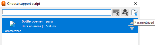

- Select the Bottle opener parts.
- From the main menu choose .
- From the script selection dialog select the parametrized script.
Tip: Use the filters to hide script types other than parametrized.
Deactivate types
Default and
Custom, leaving only
Parametrized enabled, to quickly find the script created earlier - In the

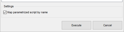

Settings section of the dialog enable
Map parametrized script by name.
Enable the mapping function for the script to run on existing parts instead of creating new part duplicates.
- Click Execute.
This applies the support variants immediately to the parts present in the buildroom and concludes this tutorial.
