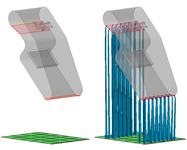

  6. Click Save and Execute to save the script and get an initial impression of generated supports with default values.
    The Bottle opener part before and after supporting with default values
