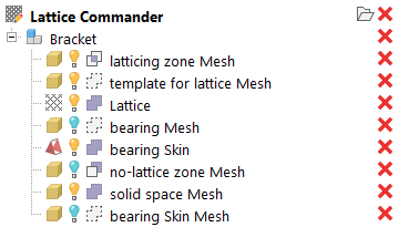

Project tree elements
A component named Bracket with a number of bodies comprising it in the project tree.
A
component represents a working set of
meshes,
skins, and
lattices, including
surface lattices. You can have multiple components loaded at once, and they are independent and do not interfere with each other. The elements inside a component are called
bodies.

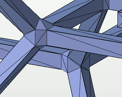

Lattice meshing options (legacy only)
- Smoothing: The otherwise simple discrete faces of the beams and their junctions are subdivided and their transitions made gradual. This generates a significant amount of triangles costing easily dozens of Gigabytes of RAM for realistic lattices. Use with care.
- Beam side count: To approximate the ideal, cylindrical beams, discrete faces are used. While this number has no significant effect when smoothing is used as well, matching the side count to the angles and the count of beams meeting in a junction can help make the junctions less bulbous.
The four variants of smoothing: None, coarse, fine, superfine.
