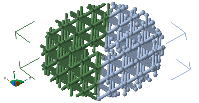

To show that you are currently editing a lattice, it is displayed in light blue, as opposed to dark green:
The light blue display color (on the right) of a lattice body indicates that its junctions and beams can be edited individually.
- To begin editing lattices, select the lattice to be edited, then, in the main menu, click Edit body.
- To finish editing, click Finish in the main menu.
Editing a lattice is only a temporary state. You can enter and exit editing at any time. Also, editing or clicking Finish after editing does not void or clear any undo states that happened before or during editing, so you can undo and redo even individual edits such as placing or moving beams, collapsing junctions, and so on, regardless whether editing is currently active.
