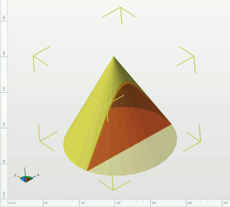

The four variants of a component: Solid mesh, skin, surface lattice, lattice
