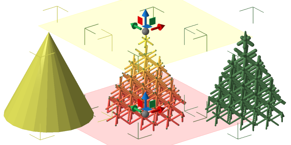

To add a thickness gradient
A thickness gradient makes beams across a span of lattice progressively thicker or thinner. You can provide XYZ coordinates for each of the beginning (highlighted with a red plane) and the end (yellow plane) of the gradient, or use the gizmos in the display.

Three steps of creating a thickness gradient. From left: The original body, its lattice with the gradient being set up, the finished lattice with gradient.
