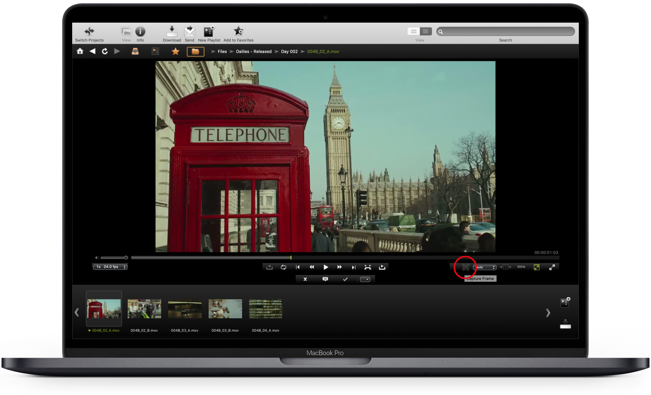

Capture and save a single video frame to your Mac
In the viewer, press the Capture Frame button
The frame captured will download onto your desktop or to where you have your download location set to.
To adjust your download location:
- Go to the PIX menu
- Select Preferences
- Under the Local Disk tab, you can set a location for your downloaded files
