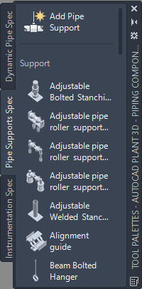

    To add a support from the project pipe support spec
    1. If the Pipe Supports Spec is not displayed on the tool palette, enable plantdynamictoolpalette.
    2. On the tool palette, click Pipe Support Spec.
    3. Click a pipe support type (for example: Beam Bolted Hanger).
    4. Snap to connect to pipe (for example: Nearest).
    5. Press ENTER to finish adding pipe supports.
