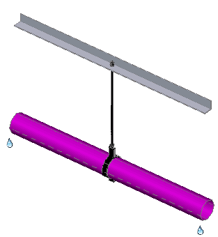

- In the drawing area, select a pipe support.

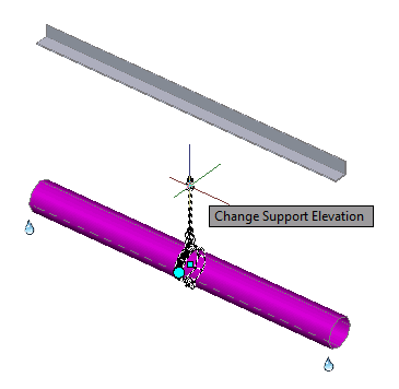

- Click on the Change Support Elevation grip. If the pipe support does not have a point-of-support an elevation grip does not display.

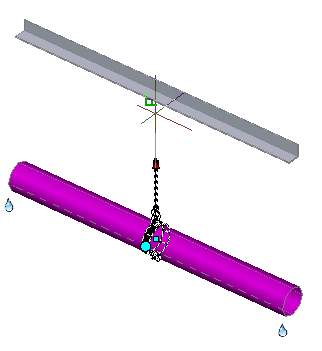

Note: If you specify the new elevation with dynamic input, you must press ENTER. Pressing TAB from the Change Support Elevation grip or the move grip does not lock the value. - Specify a new elevation (for example: perpendicular snap to a beam).
If the connection to structure is not exact, you can adjust the elevation in the properties palette (for example, change the Height dimension).
