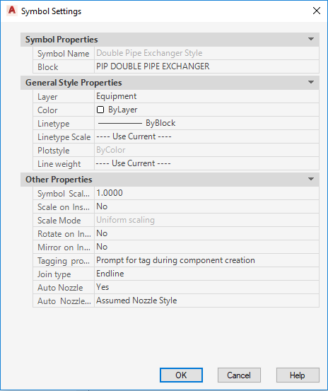

Symbol Settings Dialog Box (Annotation)
Sets the properties for the selected annotation style.
Symbol Properties
Lists the properties that control the name of the style and the geometry that is displayed when the annotation style is used.
Symbol Name
Defines the name of the style. Property is read-only when modifying an existing style.
Block
Defines the block that is displayed when the style is used. Click the [...] button to open the Select Block Drawing dialog box, where you choose from a list of available blocks.
General Style Properties
Lists the properties that affect how the text and geometry appear for the annotation style.
Layer
Defines the layer on which the style is applied.
Color
Defines the color applied to the style. The style color can be different than the layer color.
Linetype
Defines the linetype applied to the style. You can also define the linetype by layer or by block.
Linetype Scale
Defines the linetype scale applied to the style. This field is not editable.
Plotstyle
Displays the plot styles applied to the style.
Line Weight
Defines the line weight applied to the style.
Other Properties
Symbol Scale Factor
Sets the scale for the symbol when it is inserted in a drawing.
Use Target Properties
Sets whether an annotation inherits the properties of the target item or on the annotation style it is based on.
Linked
Sets whether an annotation moves with (is linked to) the annotated component or line.
Auto Insert?
Sets whether an annotation is inserted automatically, with a prompt, or is never inserted.
Offset X
Sets the distance, in units, that an annotation is offset from the annotated component or line along the X axis.
Offset Y
Sets the distance, in units, that an annotation is offset from the annotated component or line along the Y axis.
Use Leader?
Sets whether a leader is placed between the annotation and the component.
Orientation
Sets the orientation to use for the placed annotation style (orthogonal, force horizontal, force vertical, or aligned). Orthogonal mean always horizontal, unless the target is vertical, then vertical.
Description
Displays a description for a selected field.
