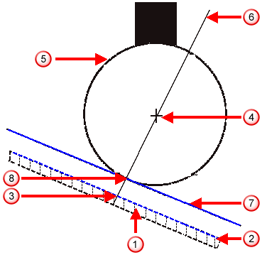

By default, PowerInspect automatically compensates for the probe radius. Each time you probe a surface point, PowerInspect receives the position of the probe centre and calculates the probe's contact point with the surface. It also calculates the deviation between the calculated and theoretical contact points.
CAD model
Theoretical surface
Theoretical contact point
Probe centre
Probe radius
Normal
Probed surface
Actual contact point
