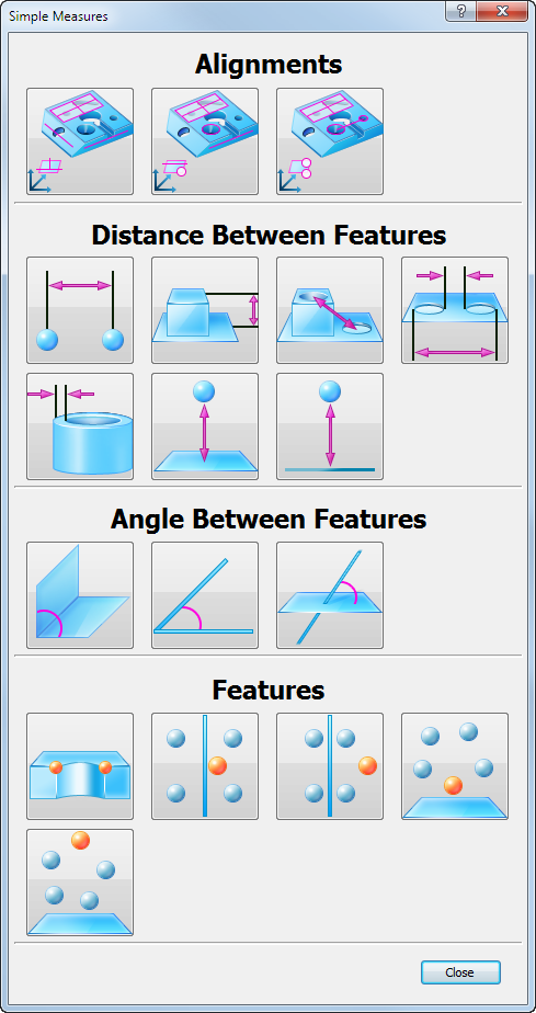

To open the Simple Measures Wizard
Use the Simple Measures wizard to select the type of alignment or measurement you want to make. It automatically creates all the items needed to calculate the item in the group, and then plays the items so you can start measuring without any preparation.
Note: The Simple Measures Wizard is available only for CNC and Manual inspections.
To use the Simple Measures Wizard:
  1. Create and open a Simple Measures group in the Sequence Tree.
  2. Click Home tab > Create panel > Simple Measure > Simple Measures.
