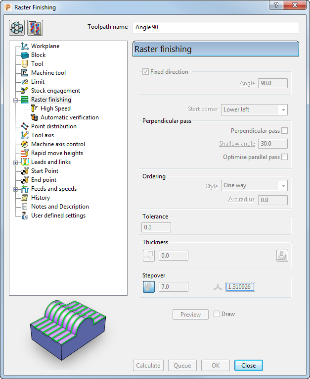

To display the active Toolpath settings
You can display the parameters, in the strategy dialog, used to create the active toolpath.
To display the toolpath parameters:
  1. Click Toolpath tab > Calculate panel > Settings to display the Strategy dialog.
    In the case of a raster finishing toolpath, the Raster Finishing dialog is displayed:
  2. Initially the Name is the only editable field. To edit other fields first click either Recycle toolpath , to edit the existing toolpath, or Copy toolpath , to create a new toolpath based on this one.
For more information, see Toolpath Strategies.
