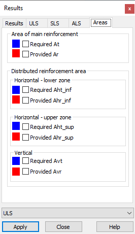

Select the Areas tab on the Diagrams dialog to select the following quantities to be displayed.
Area of main reinforcement
  • Theoretical (required) At.
  • Real (provided) Ar (resulting from the actual distribution of transversal reinforcement).
Distributed reinforcement area
Horizontal - lower zone
  • Theoretical (required) Aht_inf.
  • Real (provided Ahr_inf (resulting from the actual distribution of reinforcement).
Horizontal - upper zone
  • Theoretical (required) Aht_sup.
  • Real (provided) Ahr_sup (resulting from the actual distribution of reinforcement).
Vertical
  • Theoretical (required) Avt.
  • Real (provided) Avr (resulting from the actual distribution of reinforcement).
Note: Each of the listed quantities is accompanied by a sample of the color that will be used to present it in diagrams.
