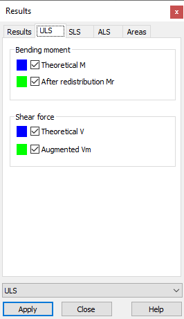

ULS, SLS and ALS forces
Select the ULS forces, SLS forces and ALS forces tabs from the Diagrams dialog to select the numerical result types on the Results tab.
Each tab selects the following force related quantities to be presented on the Results tab.
Bending Moment
  • Theoretical M
  • After redistribution Mr (in the case of absence of redistribution of moments, Mr is identical to M).
Shear Force
  • Theoretical V
  • Augmented Vm.
Note: Every modification of settings in the discussed tabs is to be accepted by clicking the Apply button.
Note: For deep-beams calculated according to the BAEL code only the min./max. values of sectional forces are obtained, therefore, no results are presented in the graphic viewer.
