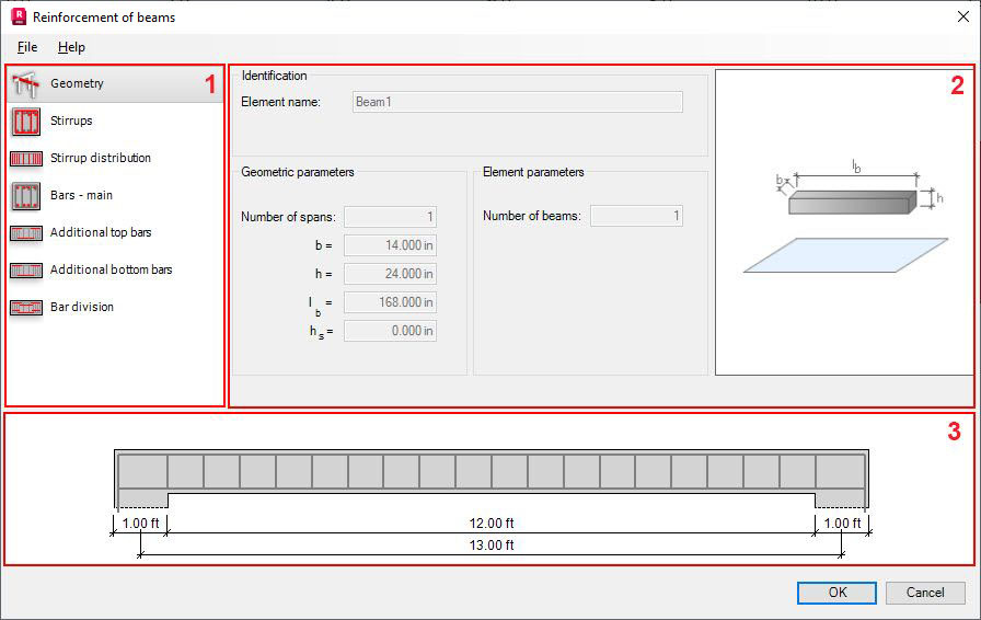

The dialog for generation of reinforcement of beams has 3 main parts:
- On the left are options for selecting components used to define beam reinforcement:
parameters of the section geometry
parameters of transversal reinforcement (stirrups)
parameters of stirrup distribution along the beam length
parameters of longitudinal reinforcement
parameters of additional bars (top and bottom)
- User reinforcement (this tab is available in Autodesk® Revit® / Autodesk Robot Structural Analysis)
- On the right, you can define parameters of the beam and reinforcement (depending on a selected component).
- At the bottom is a graphical view of a defined RC beam and generated beam reinforcement. In the view, you can select beam spans or stirrups (for example, to ensure that some of the parameters are defined only for one span of the multi-span beam) , as shown below.
selected span |
selected stirrups in the span |
