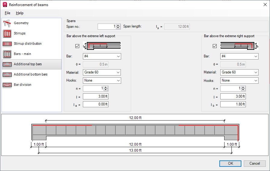

Additional longitudinal bars
Using the following 2 tabs, you can define additional longitudinal bars.
Reinforcing bars are generated separately for each beam span. Parameters of these additional top bars include:
  • Type of bar
    • or additional longitudinal bars above the left support in the span
    • or additional longitudinal bars above the right support in the span.
  • Bar parameters
    • Type, diameter, and material of bar
    • Hooks
    • Number and length of additional longitudinal bars

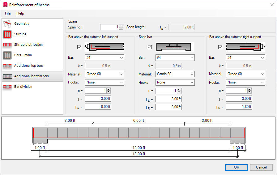

Additional bottom bars
These reinforcing bars are generated separately for each beam span. Parameters of these additional bottom bars include:
  • Type of bar:
    • additional longitudinal bars above the left support in the span
    • additional longitudinal bars in the span
    • additional longitudinal bars above the right support in the span.
  • Bar parameters
    • Hooks
