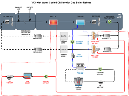

VAV w/WC & GAS
VAV with Water-Cooled Chiller with Gas Boiler Heat and Reheat - This system consists of a Variable Air Volume Air Handling Unit (AHU) served by a primary only chilled water loop and a primary only hot water loop. The VAV AHU includes a mixing box, a hot water coil and a chilled water coil. Each conditioned thermal zone is served by a single duct VAV box with a hot water reheat coil. The default ASHRAE Standard used to set the efficiency of regulated equipment is ASHRAE 90.1-2016.
Water Cooled Chiller:
Quantity: 1
Capacity: Auto-sized
Compressor Type (Screw, Centrifugal or Scroll compressor), based on capacity
Controls: Based on Capacity and ASHRAE Standard
Efficiency: Based on Capacity and ASHRAE Standard
Chilled Water Pumps:
Quantity: 1
Design Flow: Auto-sized
Type: Variable Speed, 30% minimum flow
Efficiency: Based on design flow and ASHRAE Standard
Hot Water Boiler:
Quantity: 1
Type: Natural Gas, Non-Condensing
Hot Water Pumps:
Quantity: 1
Efficiency: Based on Design flow and ASHRAE Standard
ERV:
Quantity: (1) If required, based on Outside Air Flow, Design Flow and ASHRAE Standard Requirements
Design Flow: Auto sized
Controls: Based on Climate Zone and ASHRAE Standard
Effectiveness: Based on Design Airflow, % Outside Air, Climate Zone and ASHRAE Standard
VAV AHU:
Controls: Based on Design Airflow, Climate Zone and ASHRAE Standard
Airside Economizer Type and Controls: Based on Fan Design Airflow, % Outside Air, Climate Zone and ASHRAE Standard
VAV AHU Fans:
Quantity: 1
Design Airflow: Auto-sized
Efficiency: Based on Design Airflow and ASHRAE Standard
VAV Boxes:
Quantity: 1 per thermal zone
Reheat Coil Type: Hot Water
Zone Airflow: Auto sized
VAV Box Controls: Based on Zone Airflow and ASHRAE Standard
