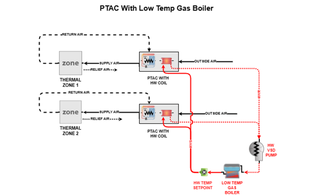

PTAC w/Low Temp GAS
Packaged Terminal Air Conditioner with low temperature gas boiler - This system consists of a Packaged Terminal Air Conditioner (PTAC) serving each conditioned thermal zone. The PTAC provides heating using a hot water coil served by a primary only variable flow hot water loop utilizing a natural gas boiler. The Gas Boiler is controlled to supply 130°F Hot Water to the Hot Water Heating Coils The default ASHRAE Standard used to set the efficiency of regulated equipment is ASHRAE 90.1-2016.
Packaged Terminal Air Conditioner (PTAC):
Quantity: 1 per conditioned Thermal Zone
Cooling: Provided by DX cooling coil
Heating: Provided by Hot Water Coil
Cooling Capacity: Auto sized
Cooling Efficiency: Based on Capacity and ASHRAE Standard
Hot Water Boiler:
Quantity: 1
Capacity: Auto-sized, using a Design Temp of 130ºF
Type: Natural Gas, Condensing
Controls: Based on Capacity and ASHRAE Standard
Hot Water Pumps:
Quantity: 1
Design Flow: Auto-sized, using a Design Temp drop of 20 ºF
Type: Variable Speed, 30% minimum flow
Efficiency: Based on Design flow and ASHRAE Standard
