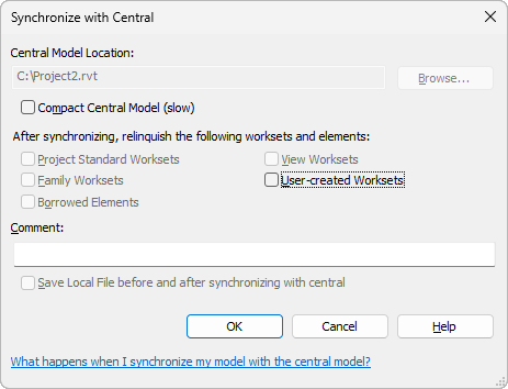

If you want to modify the Synchronize with Central settings before you synchronize with central: Click Collaborate tabSynchronize panel Synchronize with Central drop-down (Synchronize and Modify Settings). The Synchronize with Central dialog displays.
  1. In the Synchronize with Central dialog, verify the location of the central model.
    If necessary, click Browse to specify a different path for the central model. Specify the new path in the Central File Location dialog, and click OK.
  2. Select Compact Central Model to reduce file size when saving.
    Note: Selecting this option increases the time needed to save.
  3. Under After synchronizing, relinquish the following worksets and elements, select from the following options:
    • To make your changed worksets and elements available to other users, select the appropriate check boxes.
    • To synchronize the changes to central but keep the worksets and elements editable, clear the appropriate check boxes.
  4. If desired, enter a comment, up to 1000 characters, that is saved to the central model.
    You can see all comments using the Show History tool. See Viewing Workshared File History.
  5. Verify that Save local file before and after synchronizing with central is selected to ensure your local file remains synchronized with central.
  6. Click OK.
