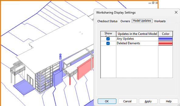

To add color to updated elements
  1. On the View Control Bar, click Worksharing Display Settings.
  2. Click the Model Updates tab.
  3. Select Show Color for Any Updates and Deleted Elements as desired.
    Note: Deleted elements display as updates if you do not apply color to them.
  4. Click Color. In the Color dialog, select the color to use and click OK.
  5. Click Apply.
    The specified color for the corresponding updates or deleted elements displays in the model.
