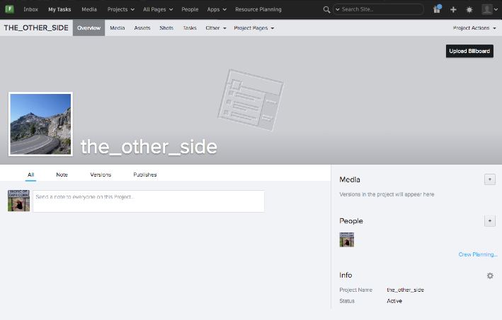

Step 1: Create a new project in Flow Production Tracking called "the_other_side.”

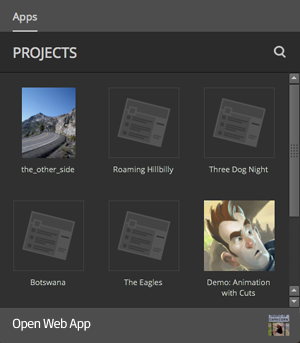

Step 3: Navigate to the project where you wish to run the Wizard by selecting its thumbnail image.

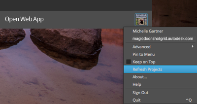

If a new project was created while Desktop was open, the Projects window may need to be refreshed to see the new projects. Select your profile avatar at the bottom right of the desktop and select Refresh Projects.

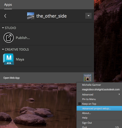

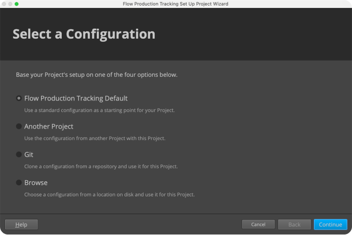

Step 4: Once the project is loaded, select your profile avatar at the bottom right of the screen. In the popup menu, select Advanced project setup… to initiate the Wizard.
A dialog box will be displayed with four options and Flow Production Tracking Default selected. At this point, you can choose to base your project's pipeline configuration on the configuration of an existing project, on a configuration in a git repository, or on a path on disk.
For this exercise, we'll choose Flow Production Tracking Default. This option will create a pipeline configuration for your project that's based on Flow Production Tracking's Default Configuration.
Step 5: Select Continue.

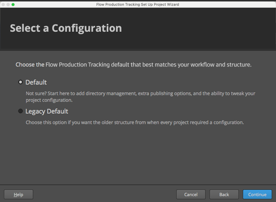

A dialog box will be displayed with two options and Default selected. At this point there’s an option to select a Legacy Default Configuration setup. This configuration setup is from an older version of Flow Production Tracking for studios who still use that version. We will use the Default for this exercise.
Step 6: Select Continue.

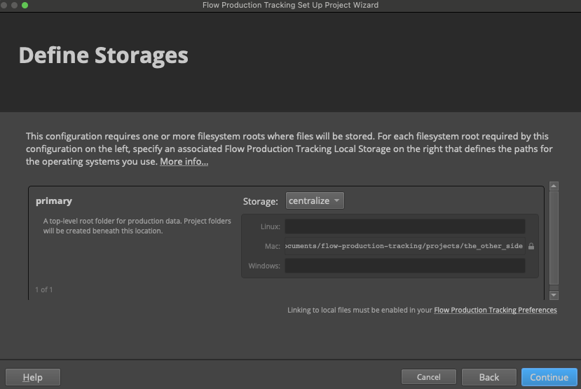

Define storage locations for project files

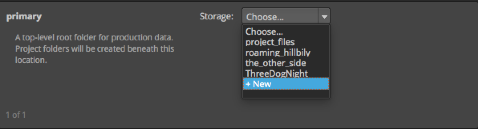

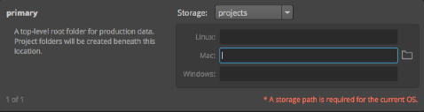

A dialog box will appear displaying a drop-down menu next to the word Storage:
Step 7: Identify where to store project data for this project. From the dropdown at the top of the dialogue box select + New and type projects in the field.
Flow Production Tracking Toolkit supports three operating systems: Linux, Mac, and Windows.

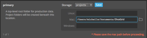

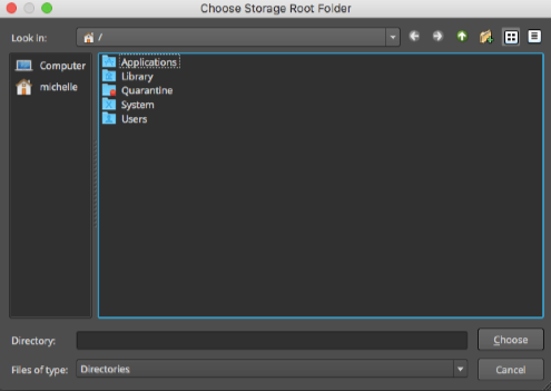

Step 8: Select the field next to the operating system utilized for storing project data. Select the folder icon and navigate to the project folder created on the filesystem prior to this exercise.
This setup allows Flow Production Tracking to have access to only the folder you identify for storing production data. When preparing for this exercise you added a projects/ directory within your Flow Production Tracking root directory. The projects/ directory is where Toolkit will store any local project related information.
Step 9: Select SAVE to identify the projects folder as the storage destination for project data.
The operating system path is automatically updated to identify the path where the project data is stored.
Step 10: Select Continue.

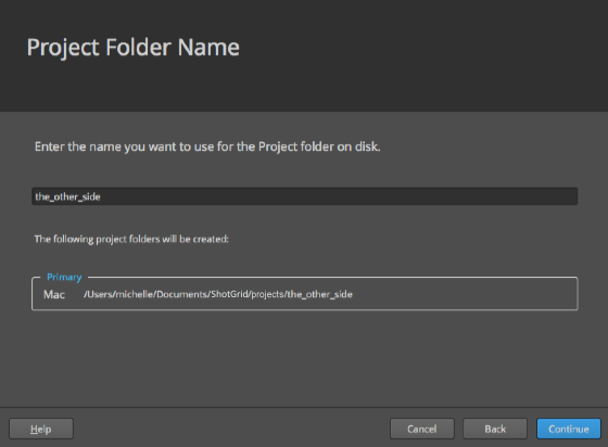

Name the Project Folder
A dialog box is displayed with the name of the project populating the text field. The name is automatically populated pulling from the project information and the path is automatically updated.

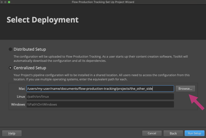

Toolkit can work in either a Distributed Setup, where the pipeline configuration is uploaded to Flow Production Tracking and cached locally for each user, or a Centralized Setup, where users access a single configuration in a shared location on disk. For this exercise we will use a Centralized Setup. You can learn more about Distributed Setups here.

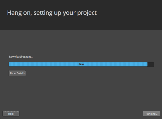

The final step generates the appropriate folders, files, and data necessary to create the configuration specific to a project.
Step 11: Under the appropriate operating system, select Browse... and navigate to the configuration folder you created when preparing for this exercise, configs, and enter the project name the_other_side. This creates the folder where the project configuration is stored. Select Run Setup and wait for it to complete the setup.

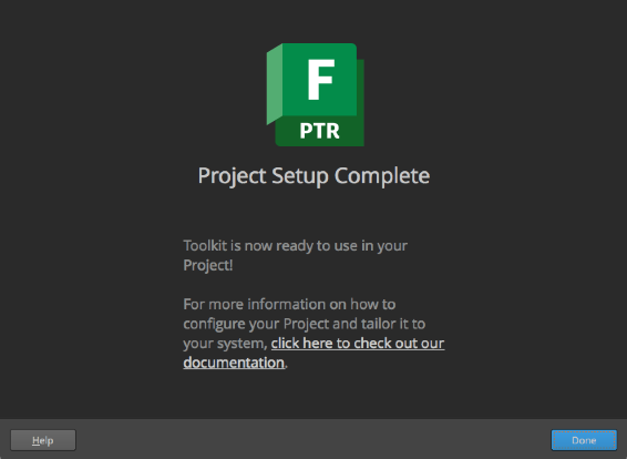

Step 12: Select Done to display the new icons populating the project windows.
Pin the app to the menu bar to allow quick access to Flow Production Tracking Desktop: select your avatar and select Pin to Menu.
You’re done; the project setup is complete. You now have a Toolkit pipeline configuration for your project in the location you specified, based on the Default Configuration, and you’re ready to start customizing.
Take a look in the configs folder and you will find several folders and files. Explore a little to see what’s in there.
