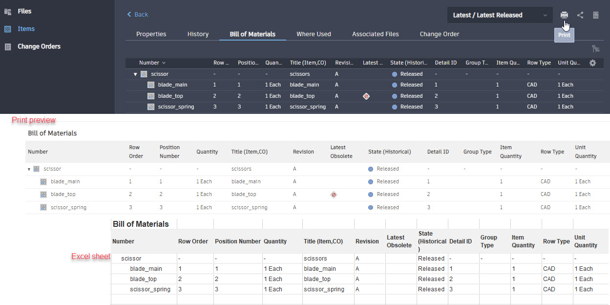

You can extract data from the Thin Client to an Excel spreadsheet for your reference.
To copy the data to the Excel spreadsheet:
On the Files, Items, or Change Orders details tab, click the Print icon.
A preview of the tab is displayed.
Select the rows to copy the data to the Excel spreadsheet. If you are copying items, select BOM levels to include BOM levels in the print preview.
The values copied and pasted to the Excel spreadsheet preserves the Thin Client layout.
Click Cancel on the print preview window once copied.
