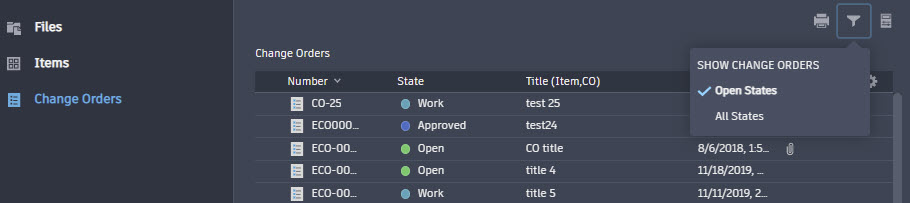

Customize the Change Order View
You can filter the view to only show change orders that are in Open state (Create, Open, Work, Review, Approved, Rejected) or select All States to list all change orders including Closed or Cancelled states.
To customize the change order view:
Click the filter icon in the upper right corner of the Change Orders workspace.
Select the "Open States" or "All States" filter. If the Open States filter is selected, all change orders in Closed or Cancelled state are hidden from the view.
Note: The Open States include all change orders that are in Create, Open, Work, Review, Approved, and Rejected. All States include change orders in Open state as well as in Closed or Cancelled states.
By default, the Open States filter is selected.
