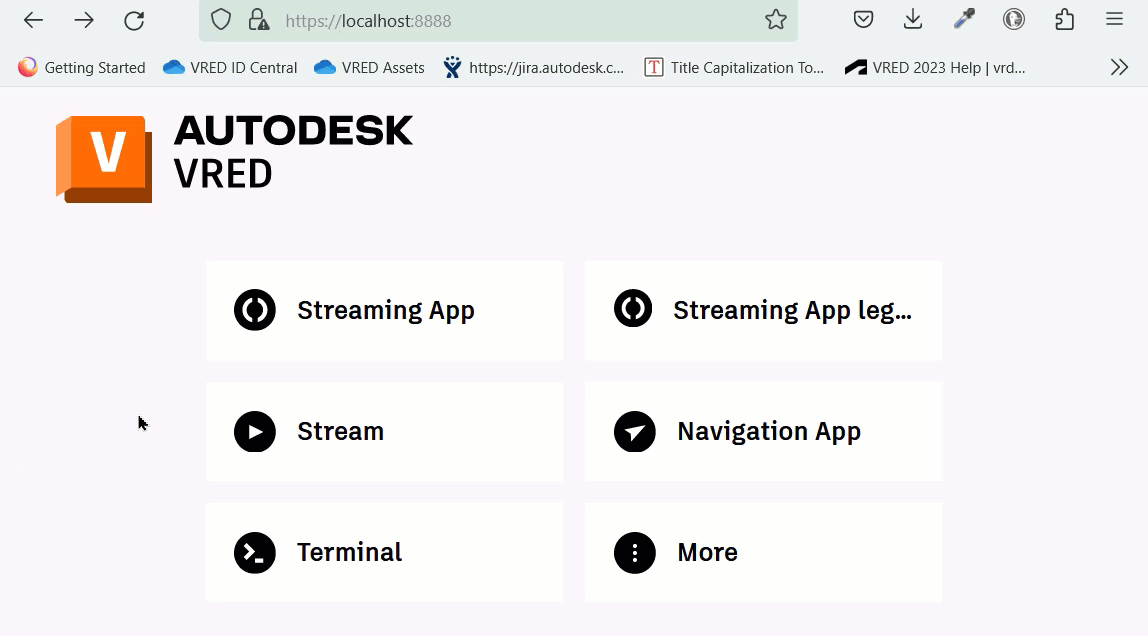

When someone mentions VRED Stream, they are talking about the Stream JPG and Stream H264 features. These are live image streams of a VRED viewport. In the VRED Stream, you can navigate in the scene, use touch sensors, and interact with HTML 5 content.
VRED Stream web interface

  1. Open a VRED scene.
  2. Select Edit > Preferences > General Settings > Web Interface and ensure Enable Web Server is activated.
    Note the port number. The default is 8888.
  3. Click OK.
  4. Open a web browser on your device.
  5. Enter either localhost:8888 or YourIP:8888.
  6. Select Stream JPEG or Stream H264.
