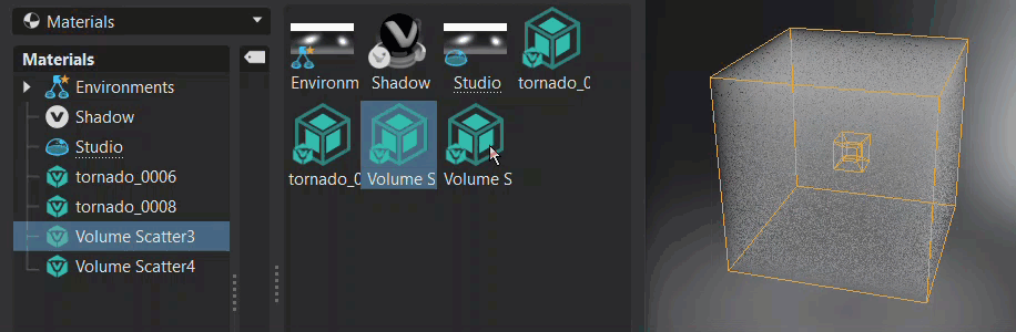

To create a volume material, in the Material Editor, select Create > Create Material > Volume Scatter or OpenVDB.
To change the volume in your scene, drag and drop a volume scatter material onto the volume's central cube in the viewport.
Changing a volume by dragging and dropping another onto an existing volume in the viewport
