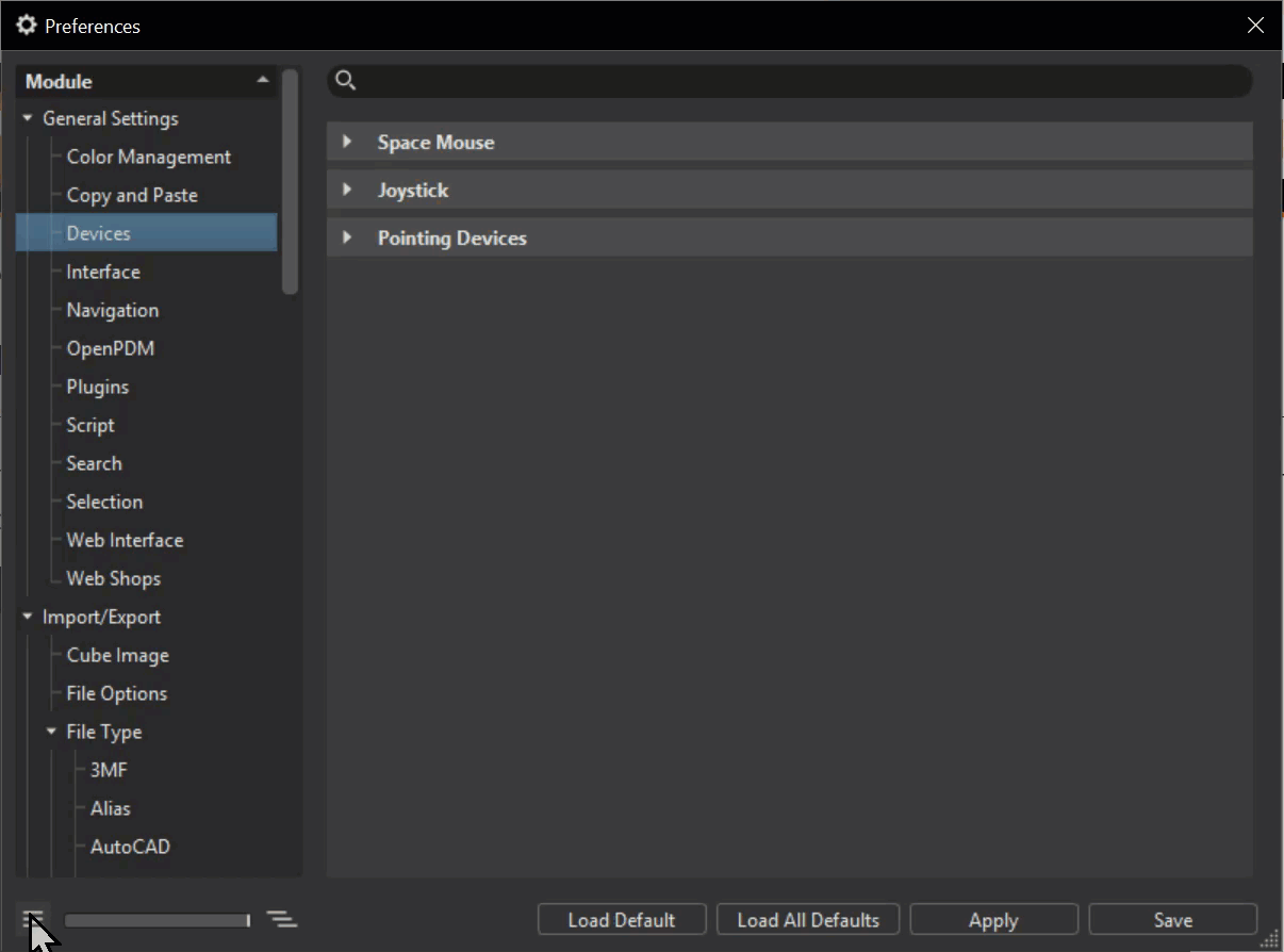

The VRED preferences are comprised of a tree view along the left, a search bar and preferences to the right, and buttons along the bottom for resetting tools to their defaults, applying changes, and saving them.
VRED preferences
The tree view to the side is organized into six main categories:
  • General Settings - Find color management, copy/paste, device, interaction, navigation, OpenPDM, plugin, script, search, selection, web interface, and web shop preferences.
  • Import/Export - Find cube image, file option, file type, and tessellation import and export preferences.
  • Scene - Find animation, asset, bake, camera, material, metadata, reference, scenegraph, transform, and uv preferences.
  • Interaction - Find annotation and collaboration preferences.
  • Extended Reality - Find HMD and an assortment of different VR and MR preferences.
  • Rendering - Find cluster, final renderpass, render settings, and render window preferences.
Use the slider at the bottom to collapse or expand the tree.
Preferences slider
For information on the different preferences, click the links at the end of this topic.

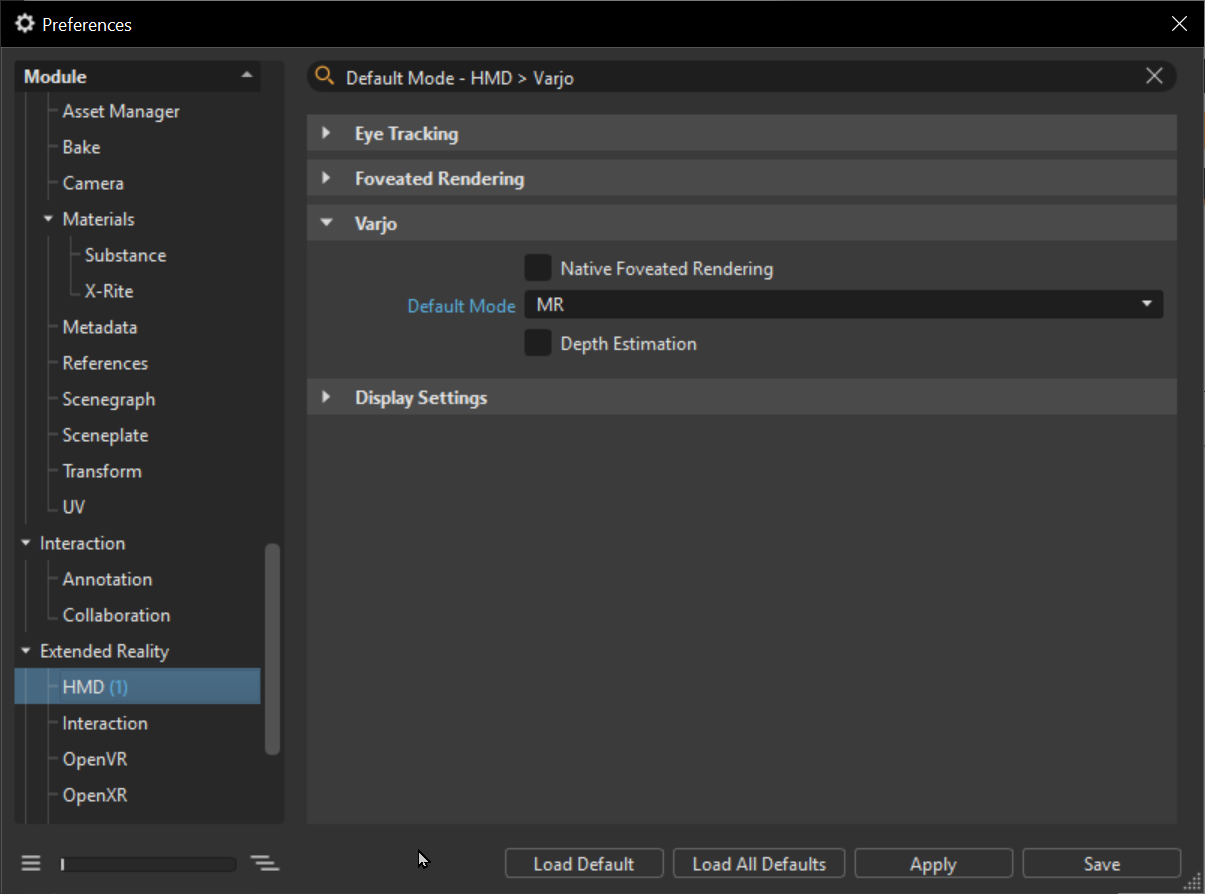

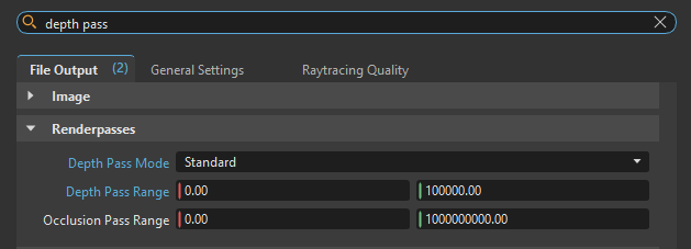

Preference Searches
Use the Search field at the top of the Preferences module to quickly and easily find a specific preference.
In the Search field, once there are two characters, VRED starts to generate a list of search results. The matching part of each search result is highlighted. Click an entry to load the preferences, with any matching options highlighted blue. If there is only one match, it is loaded and displayed.
Search result appears in bold
For modules with multiple tabs, the number of matches highlighted blue appears next to the tab name.
Number of matches highlighted blue appears next to the tab name
When a search is performed, the TOC categories expand and display the number of search hits next to modules containing search matches. Clicking one of these displays that module's preferences in the section to the right, with matches highlighted blue.
