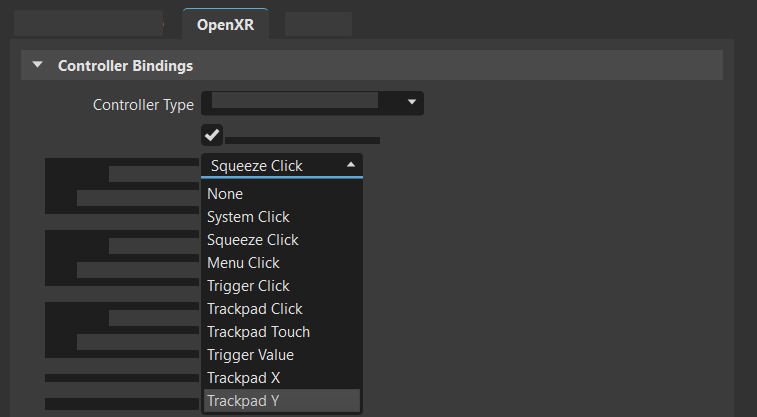

Disabling an Action
To disable an action, so it is not accessible in a session, do the following:
  1. In Edit > Preferences > Extended Reality > OpenXR, select the desired action from the list.
  2. Open the drop-down menu next to the action and select None. Now, the action cannot be triggered during a session.
  3. When finished, press Apply and Save.
Note:
In the future, to make the action accessible, select a target from its drop-down, such as Menu Click or X Touch. Then, when finished, press Apply and Save.
Disabling a Controller Button
Any controller button can be disabled through the Edit > Preferences > Extended Reality > OpenXR preferences. In the controller bindings list, ensure the button is not assigned to an action. If it is, select another option from the action's drop-down menu. When finished, press Apply and Save.
