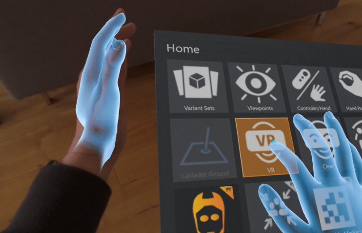

  • Use Tracked Hands in XR - Only available for Varjo XR-3 users. Sets the default to always track hands in VR when enabled. If Tracker is set to Varjo Integrated Ultraleap, hand tracking is also enabled in XR for supported HMDs.
  • Show Tracked Hands in MR - Sets the default to always display virtual tracked hands when in MR. This comes in handy for when Depth Estimation disabled, as the tracked hands are displayed over your real hands to help with VR Menu selection.
