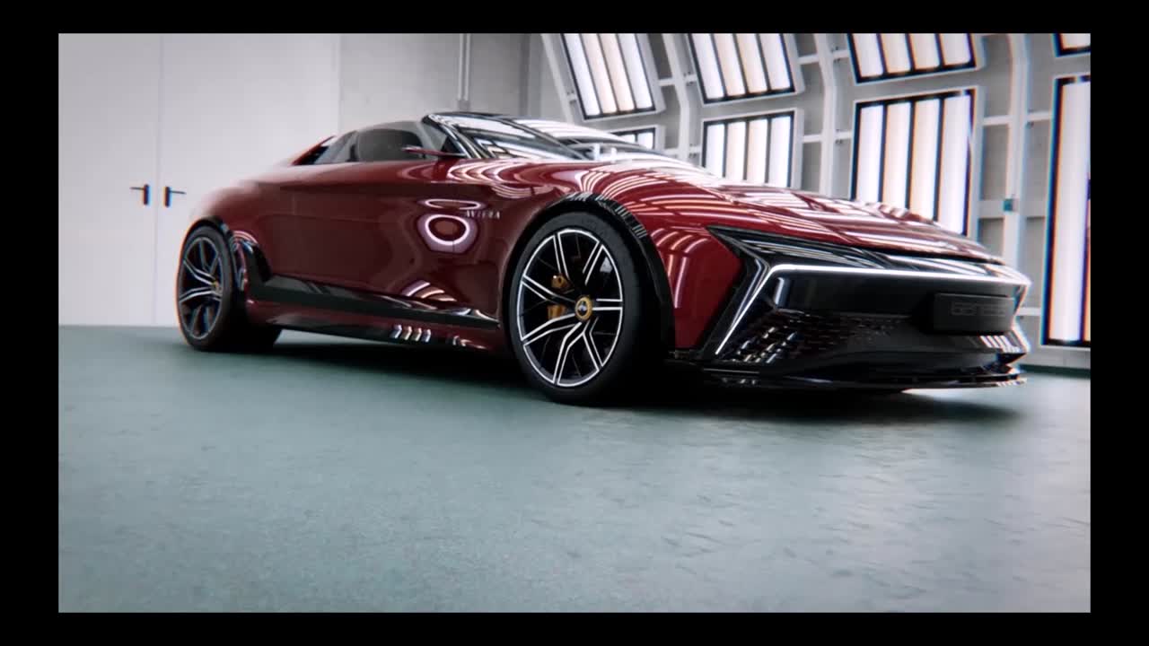

General Improvements (2026.1)
Find GPU raytracing, scripting, OpenXR, annotation, and material improvements, such as the new Ignore Inactive Properties option, support for different brushed metal mapping types, and new glass projections. Plus, we added 14 translucent and opaque AxF materials from Covestro to the VRED Library and Covestro Web Shop.

Video captions: Improvements in material handling, memory consumption, and Python scripting support further optimize your workflow.
OpenXR now supports Flashlight and Measurement tools, virtual button events, and improved hand-tracking precision, enhancing the functionality and precision of your interactions.
VRED Professional 2026 Update 1 delivers features designed to boost productivity and creativity. From advanced constraints and rendering enhancements to improved user experience and material integration, this update significantly enhances the realism, efficiency, and collaborative capabilities of your 3D visualization workflow.
Thank you for watching! Stay tuned for more updates and enhancements. Don't forget to leave your feedback and subscribe for the latest tips and tutorials. Transform your workflow with VRED Professional 2026 Update 1, and visualize your designs like never before.
