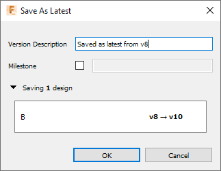

    The Save As Latest dialog displays. It indicates that you are saving an older version as the latest version.
    save as latest dialog
  3. Enter a Version Description.
  4. Optional: Check Milestone if the changes represent a significant design iteration.
  5. Click OK.
The design is saved as the latest version.

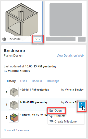

  1. In the Fusion Data Panel, navigate to the design you want to update.
  2. In the lower-right corner, click the version vX dropdown, where X is the version number.
  3. Click the version you want to save as the latest version.
  4. Click the More button vertical more icon.
  5. Click folder icon Open.
    data panel - open version
    The version of the design opens in the canvas.
