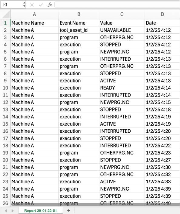

A Report is a detailed CSV document that contains status history data from all or specific machines on the shop floor.
Each report contains four column headers:
  • Machine Name: The machine that experienced the event.
  • Event Name: The type of event that occurred.
  • Value: The machine status at the time of the event.
  • Date: The timestamp for when the event occurred.
csv report open in excel
