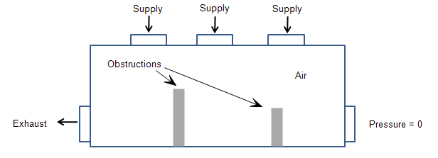

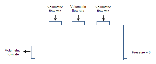

Air is mechanically moved in and out of the interior space at known conditions. Use boundary conditions to specify these conditions and their locations.
If all inlet and outlet flow rates are known, assign a volume flow rate condition to all openings, except one. Assign a Static Gage Pressure = 0 to this remaining outlet.
Some additional considerations for flow boundary conditions:
When assigning flow conditions, it is always a good idea to verify the flow direction with the arrow displayed on the surface. If the arrow indicates the flow is in the wrong direction, click the Reverse normal button on the Boundary Condition quick edit dialog.

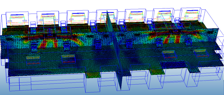

A basic guideline for a high-quality analysis model is that the mesh distribution be sufficient to resolve the flow and temperature gradients efficiently. In regions where the flow circulates or experiences large gradients (such as in wakes, vortices, and separation regions), a finer mesh is required.
For most models, use Automatic Sizing to define the mesh distribution. It may be necessary to locally refine the mesh on geometric features that are highly detailed. For more information about Mesh Autosizing and model preparation...
In some cases, it may be necessary to adjust the Minimum Refinement Length to reduce their effect on the overall mesh count.
