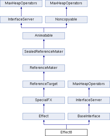

#include <sfx.h>
Extension to class Effect, new to 3ds max 8.
This class extends the Effect class through the addition of new methods.
All new Effect plugins should derive from the class. All existing Effect should ideally be re-compiled and derived from this class.
An Effect8* can easily be retrieved from an Effect& by calling: Effect8::GetEffect8(Effect& effect)
Inheritance diagram for Effect8:Public Member Functions | |
| virtual bool | SupportsBitmap (Bitmap &bitmap)=0 |
| Returns wether the given bitmap is supported by the effect. More... | |
| virtual CoreExport BaseInterface * | GetInterface (Interface_ID id) |
| The InterfaceServer mechanism is used to retrieve a Effect8* from a Effect*. More... | |
| virtual CoreExport void * | GetInterface (ULONG id) |
| The compiler will hide this overload of GetInterface() unless we define it here. More... | |
