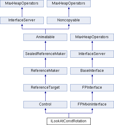

ILookAtConstRotation Class Reference
ILookAtConstRotation Class Referenceabstract
#include <istdplug.h>
Class Description
See Also
Class Control, Class FPMixinInterface.
Description:
This class is an interface to the LookAt Constraint rotation controller. You can obtain a pointer to the list control interface using; GetILookAtConstInterface(cd). This macro will return (ILookAtConstRotation*)(CD)->GetFPInterface(LOOKAT_CONSTRAINT_INTERFACE).
LOOKAT_ROT_PBLOCK_REF may be used to access the look-at controller's references:
All methods of this class are Implemented by the System.
+ Inheritance diagram for ILookAtConstRotation:
