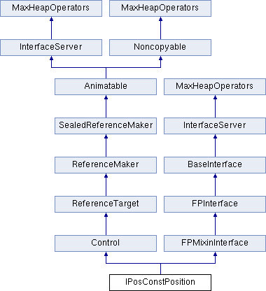

+ Inheritance diagram for IPosConstPosition:
