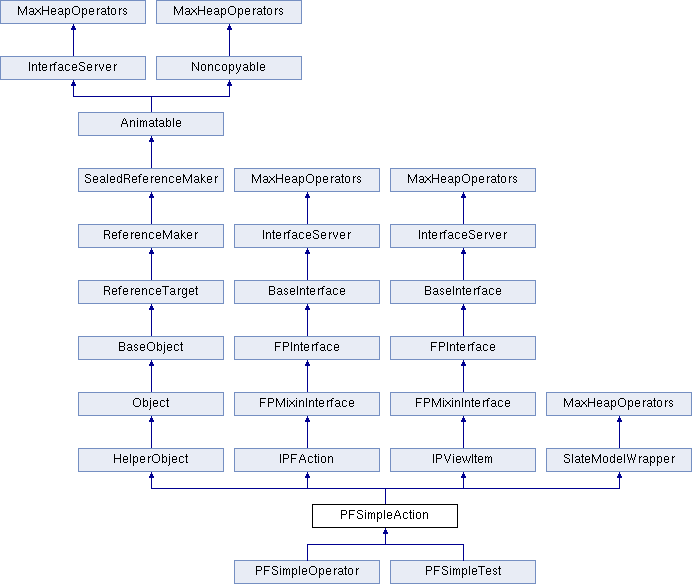

#include <PFSimpleAction.h>
Inheritance diagram for PFSimpleAction:Public Member Functions | |
