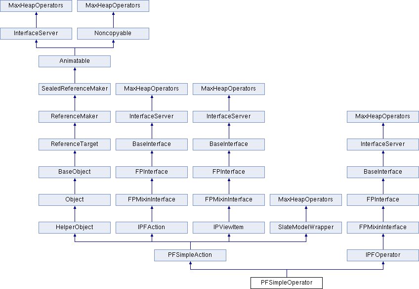

#include <PFSimpleOperator.h>
Inheritance diagram for PFSimpleOperator:Public Member Functions | |
| PFSimpleOperator () | |
| virtual PFExport | ~PFSimpleOperator () |
| virtual PFExport BaseInterface * | GetInterface (Interface_ID id) |
| virtual bool | Proceed (IObject *pCont, PreciseTimeValue timeStart, PreciseTimeValue &timeEnd, Object *pSystem, INode *node, IObject *integrator) |
