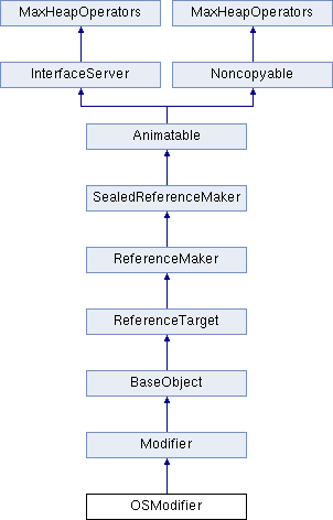

#include <object.h>
This is a base class developers creating object space modifiers may derives their plug-ins from.
It simply provides a default implementation of SuperClassID().
Inheritance diagram for OSModifier:Public Member Functions | |
| SClass_ID | SuperClassID () |
| Implemented by the System. More... | |
