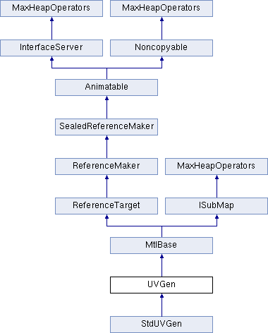

The following four methods are the only ones a plug-in needs to call typically:
+ Inheritance diagram for UVGen:
