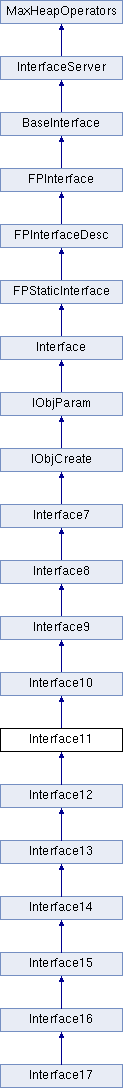

Extends Interface10 Client code should retrieve this interface using GetCOREInterface11.
Inheritance diagram for Interface11:Public Member Functions | |
