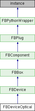

Optical device class.
Inheritance diagram for FBDeviceOptical:Public Member Functions | |
